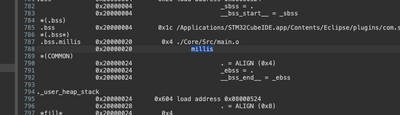

Here it is, seems like it's fine?
Hi Andrew, thanks for pointing that out. It's a typo; kindly ignore. It seems to happen whether I use static or not.

Seems like SysTick_Handler had a valid memory region:
