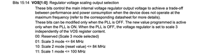

Yup, hard fault, thanks for all your help. Seems like I had an issue with my clock setup - when I ran it at 75MHz, I think I was supposed to set the power control scaling for it to be able to go that high. The system defaults to scale 2, which supports only lower clock frequencies; anything greater would need this code to be put before the PLL setup.
The reference manual doesn't really state that you have to do this for 75MHz, it says only if you run less than 100MHz, but I guess I needed it.
 Enable interface clock and set the internal voltage regulator scale to scale 1
    RCC->APB1ENR |= RCC_APB1ENR_PWREN;
    PWR->CR |= PWR_CR_VOS;
