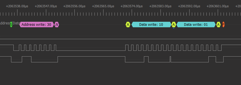

I attached a trace of a working write

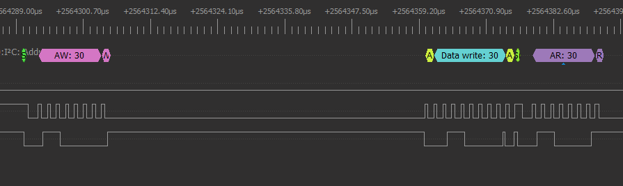

and a not working read
2019-04-02 11:21 PM
I used byte wise transfers and they work. To bad HAL does not clearly statzes how to do sequential transfers correctly.
