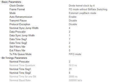

I am using a Riverdi STM32 Embedded Display RVT50HQSNWC00-B and having issues with the FDCAN bus. I am capable of writing to the TxFifo and can communicate with an external device in external loop back mode and normal mode. In external and Internal Loop Back Mode, nothing is written to the RxFifo. I am trying to use the board as a receiver not a transmitter. Are there any examples of FDCAN Rx communication with an external device using the STM32U5A9NJH6Q chip. When using CubeMX, there isn't any options for setting RxFifo elements in FDCAN configuration. Does this mean this board cannot be used a reciever, and only can transmit.

Ill try to be more clear.
/* Check that the Rx FIFO 0 is not empty */
if ((hfdcan->Instance->RXF0S & FDCAN_RXF0S_F0FL) == 0U)
/* Update error code */
hfdcan->ErrorCode |= HAL_FDCAN_ERROR_FIFO_EMPTY;
return HAL_ERROR
I am trying to understand why the RxData is not updating correctly.
CubeMX doesn't allow me to edit any of Rx elements.

Yes you have understood correctly. I will focus on Loopback mode. Could this be a version issue with IDE/TouchGFX/CubeMX?
My configuration for filters is this.
sFilterConfig.IdType = FDCAN_STANDARD_ID;
sFilterConfig.FilterIndex = 0;
sFilterConfig.FilterType = FDCAN_FILTER_MASK;
sFilterConfig.FilterConfig = FDCAN_FILTER_TO_RXFIFO0;
sFilterConfig.FilterID1 = 0x123;
sFilterConfig.FilterID2 = 0x555;
if (HAL_FDCAN_ConfigFilter(&hfdcan1, &sFilterConfig) != HAL_OK)
/* Filter configuration Error */
Error_Handler();
