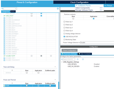

Hi Everyone,
I was able to get it to work if you update: USB_HS_REGEN to 'enabled' under the power and thermal tab

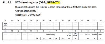

I am experiencing the same issue on the NUCLEO-H7S3L8.
USB_OTG_GRSTCTL_CSRST is stuck to 1
During usb configuration/initialisation

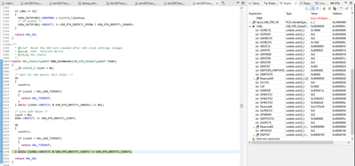

static HAL_StatusTypeDef USB_CoreReset(USB_OTG_GlobalTypeDef *USBx)
__IO uint32_t count = 0U;
/* Wait for AHB master IDLE state. */
do
count++;
if (count > HAL_USB_TIMEOUT)
return HAL_TIMEOUT;
} while ((USBx->GRSTCTL & USB_OTG_GRSTCTL_AHBIDL) == 0U);
/* Core Soft Reset */
count = 0U;
USBx->GRSTCTL |= USB_OTG_GRSTCTL_CSRST;
do
count++;
return HAL_TIMEOUT;
} while ((USBx->GRSTCTL & USB_OTG_GRSTCTL_CSRST) == USB_OTG_GRSTCTL_CSRST); //<<< Never leaves this state!!!
return HAL_OK;
Can someone help with the above?

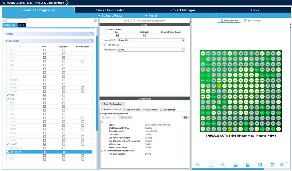

I have tried to create a new example from the .ioc file, but it does not work since there are differences between files.
Using STM32CubeIde for a new project and adding USBPD, no reference to device TCPP0203 is included, so VBUS is not enabled in HOST mode.

I reproduced the issue on my side too and reported it to dedicated team. It seems the configuration of USB core in both instances is not correct after code generation. In fact, BSVLD bit field should be set in OTG_GOTGCTL.
