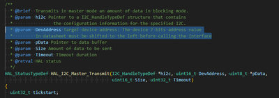

I figured it out and it was right in front of me. I had forgotten to bit-shift the device address by 1. And even my address scan failed here because I only scanned up to 0x7F, not up to 0xFF.
So I can now read the slave status with:
const uint8_t devAddr = 0x64 << 1; // CubeMX uses only the 7 most-significant bits as address
const uint8_t regStatus = 0x00;
state = HAL_I2C_Master_Transmit(&hi2c1, devAddr, &regStatus, 1, 1000);
uint8_t status;
HAL_I2C_Master_Receive(&hi2c1, devAddr, &status, 1, 1000);
I feel silly because the docblock clearly states this:
I figured this out because I was looking at the logic analyzer during the address scan and I saw each address scroll by twice (e.g. 0x00, 0x00, 0x01, 0x01, etc.) instead of incrementing each time.
