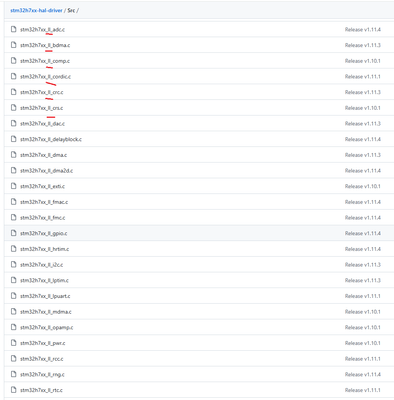

There is no SPL library for H7. If you mean by that using low level driver you can use LL implementation available in HAL:
But not all peripherals have this implementation: FDCAN as an example.
