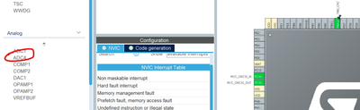

The posted code doesn't use ADC4 at all as far as I can tell. No MX_ADC4_Init call. No other calls in main().
In the IOC file, ADC4 is not enabled.
Am I missing it somewhere?

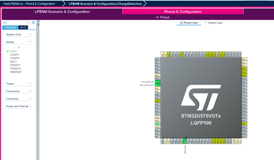

@TDK I configure ADC4 in LPBAM configuration.
I run ADC4 in MX_ADC4_Init() (LPBAM/ChargeDetection/lpbam_chargedetection_volmealoop_config.c)
