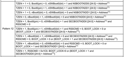

But I've just realized in AN2606, that, from my understanding:
- The U535 devices uses Pattern 12 to enter the bootloader
- The pattern 12 doesn't have "main flash empty" condition like most other patterns/families.
In this pattern 12, I see lots of conditions that I don't really understand (especially the ones with NSBOOTADD0, reference that is not documented anywhere else in this document).
Is there a way to enter the bootloader by using only the USB connection, without actively forcing BOOT0 to 1 ?
On a brand new chip, no. You'll need either ST-Link (SWD) or BOOT0 control to enter the bootloader as far as I can tell.

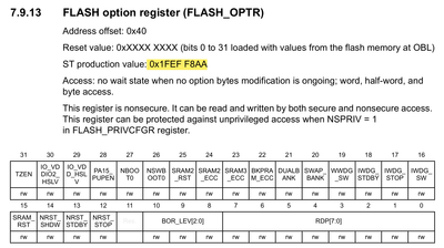

These refer to option bytes which will be listed in the reference manual. To program option bytes, you will need to use the ST-Link connection, which is what you're trying to avoid so that doesn't really help.
