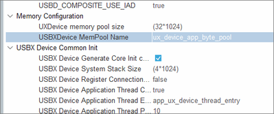

Are you sure about UX_DEVICE_APP_MEM_POOL_SIZE? It should not exceed total size of available memory. Also have you tried the example from cube firmware without changes in the config and HW setup?
2024-01-25 12:54 PM
I had to reduce the UX_Slave_Request_Data_memory to 512 from 2048 to avoid crashing, even though I increased the UX Device mempool size to 32K in an attempt to stop crashing when using 2048, which did not resolve. The demo code uses 16K and 512.

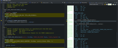

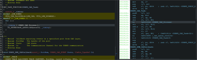

2024-01-26 11:49 AM - edited 2024-01-26 11:50 AM
The above is the working demo code (2021) with a breakpoint to check USBPD_CAD_Process(); I found no source code for this function. The callback is working fine.
Below is the issue code (2024) with the same breakpoint as above; the callback is implemented but not run. I don't know what is happening in USBPD_CAD_Process() or why it is not calling a callback. The callback was implemented by the init code (from CubeMX), and the demo code was copied (2021).
Because I don't know what in USBPD_CAD_Process(), do they run callback? what makes it work for the callback code to be executed?
