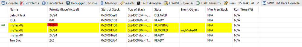

You can also observe this behavior directly in the debugger by following these steps:
In contrast, when using semaphores (which do not support priority inheritance), you may notice that the scheduler continues running other higher priority tasks (such as myTask04), while myTask02 is starved and unable to run to release the semaphore, thereby blocking myTask03.

I have verified that priority inheritance still occurs with your code when using STM32CubeIDE v1.19.0.
