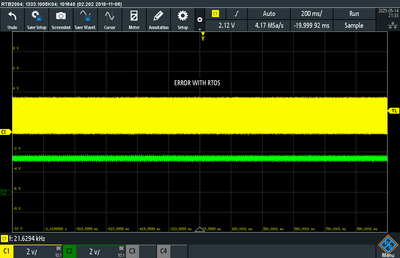

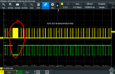

The interface works and I can also kind of work with fatFS, f_mount, f_open works basiclly, but sometimes I got a FR_DISK_ERR. On my scope I can see that the SD clock is always on when the error occures. So I think there is an issue with the low level driver level or better say somethimg is going on with the diskio layer. Please see the attached pictures of working f_mount and f_open and the f_open where the clock doesn't stop.
I'm using FreeRTOS and I have a dedicated SD_Card Task.

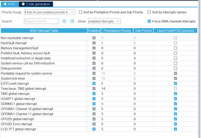

The interrupt priority for sysTick is the highest see .ioc config:
Enabling the interrupts before HAL-Delay has also no influence to the issue:

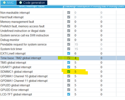

2025-05-14 6:41 AM
Hello @Julian_
You did check with priorities of Timer (Timer used as time base) interrupts higher (Lower numerically) than SDMMC.
2025-05-14 8:59 AM

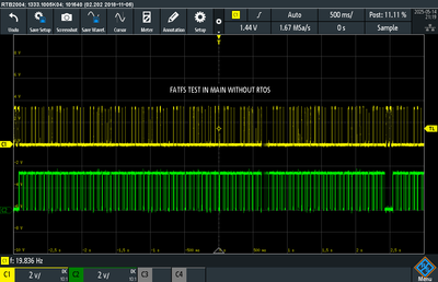

@Saket_Omwhen Time base: TIM2 global interurrupt priority is set to 4 and SDMMC1 global interrupt to 5 the test code finally works:
Runs in a while true loop and I checked the scope, seems to work:
maybe this sequence is a little bit suspicious, but all in all there is not the "never-ending-clock-issue":

2025-05-15 1:05 AM
Hello @Julian_
When using FreeRTOS, ensure that interrupt priorities are not set higher (i.e., lower numerical values) than the default priority level of FreeRTOS, which is 5.
/* The highest interrupt priority that can be used by any interrupt service
routine that makes calls to interrupt safe FreeRTOS API functions. DO NOT CALL
INTERRUPT SAFE FREERTOS API FUNCTIONS FROM ANY INTERRUPT THAT HAS A HIGHER
PRIORITY THAN THIS! (higher priorities are lower numeric values. */
#define configLIBRARY_MAX_SYSCALL_INTERRUPT_PRIORITY 5
