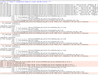

Can't get rid of the below error:
"make: *** No rule to make target 'C:/Users/LBzdega/Downloads/STM32CubeU5-main/Drivers/STM32U5xx_HAL_Driver/Src/stm32u5xx_hal.c', needed by 'Drivers/STM32U5xx_HAL_Driver/stm32u5xx_hal.o'. Stop."
2025-09-11 1:55 AM
Hello @aristot
Could you please verify whether the file stm32u5xx_hal.c exists in the following path: "C:/Users/LBzdega/Downloads/STM32CubeU5-main/Drivers/STM32U5xx_HAL_Driver/Src"
Additionally, please check your Makefile to ensure that the path to stm32u5xx_hal.c is specified correctly.
2025-09-11 4:52 AM
In fact it was empty. For some reason Git didnt pull content of this directory.
Now have below issue:
I don't see anywhere the "stm32u5xx.h". There is only "stm32u5xx_hal.h"
Not sure where to fix this.
2025-09-11 5:12 AM - edited 2025-09-11 5:20 AM
Hello @aristot
This repository has been created using the git submodule command. Please check the instructions below for proper use.
--recursive has to be specified as shown below.git pull git submodule update --init --recursive
For more details please check the link below:
STM32CubeU5/README.md at main · STMicroelectronics/STM32CubeU5 · GitHub
The file "stm32u5xx.h" is under "STM32CubeU5\Drivers\CMSIS\Device\ST\STM32U5xx\Include"
