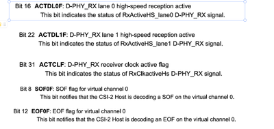

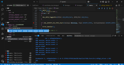

I want to use N657B0 to drive VD55G0, and the camera side can already enter the Stream state. After I use the function HAL_DCMIPP_CSI_PIPE_Start, I track the variable csi_instance through single-step debugging and find that several bits in its SR1 register are inconsistent with the normal state. And I find the defination about these.The normal state is 1 but I get 0.Could you please tell me what the reason for this might be?
Is the issue caused by a voltage supply problem in the hardware connection, or by inadequate rate matching in the port?

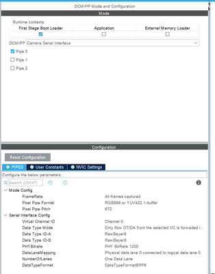

That is my configuration.

Could you please first correctly reorder the configuration and share if the problem persists?
