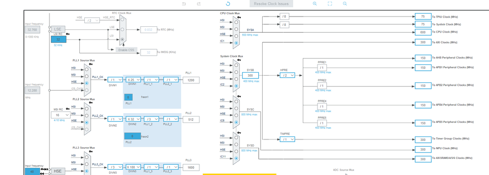

2. Set the XSPI1 clock to 200MHz. Here is my system clock configuration:

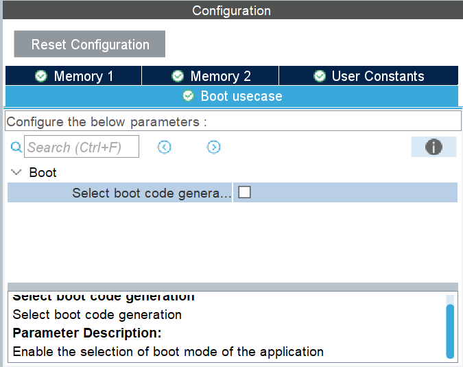

Hi @pawatJoy
With the memories configured, you didn't configure the addresses and offsets in boot use case tab copying from the serial FLASH NOR (Memory 1) to the external PSRAM (Memory 2)
Best regards,
FBL
