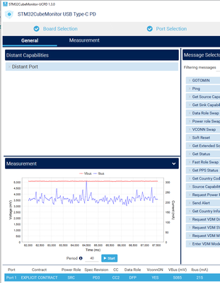

If you want to have the details of the power delivery contract, you can have that on the UCPD monitor.
Are you aware of this tool (wiki link) ?
You can display VBUS voltage and current :
Or even use the trigger button to display some info in the trace : see this part of the wiki
