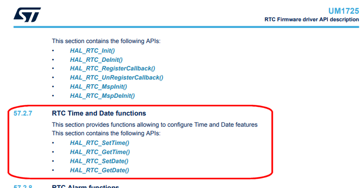

 The HAL gives you functions to set the RTC Time & Date:
