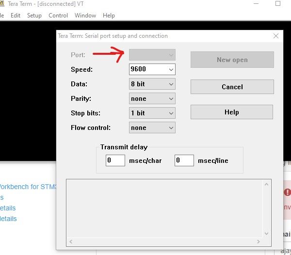

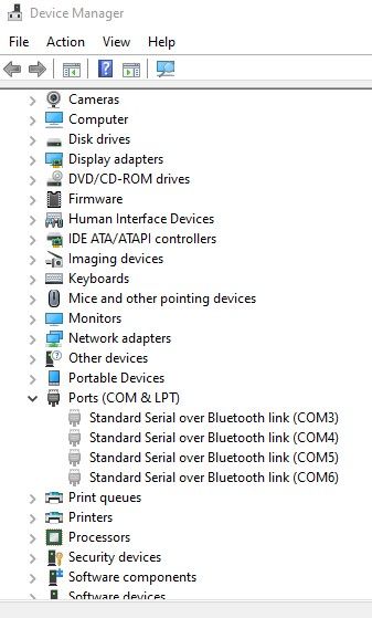

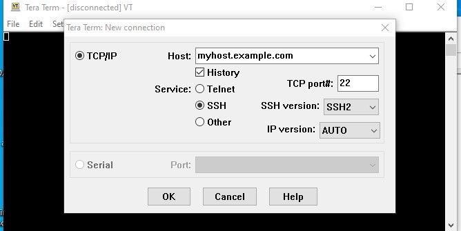

When I plug this device into Windows 10 machine, I am not able to connect to the device. I do not see any COM port in Device manager and also Tera Term serial port option is greyed out.

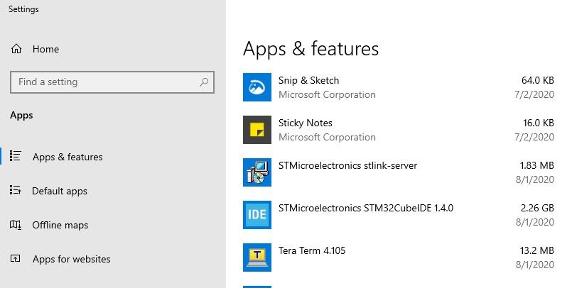

I did install STSW-LINK009. I have tried this is 3 windows device and getting same issue.

Device manager
Tera term
Installed ST programs
