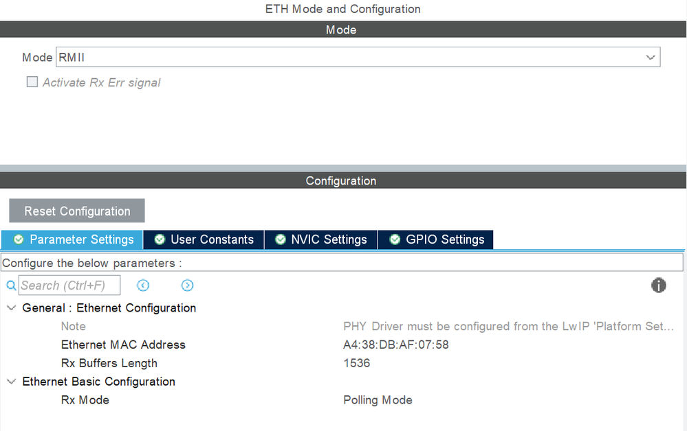

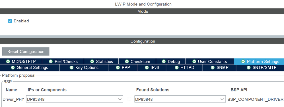

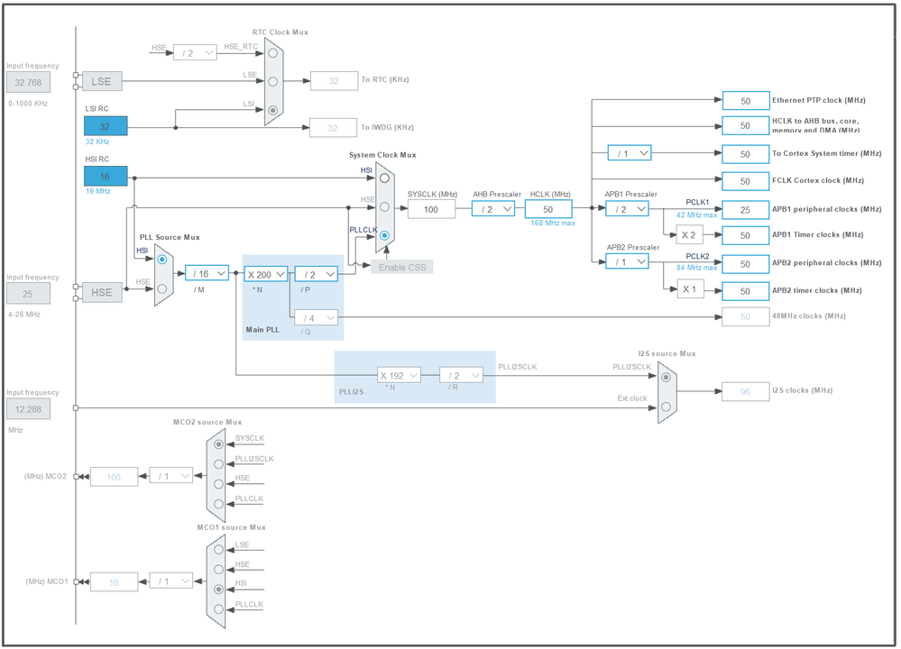

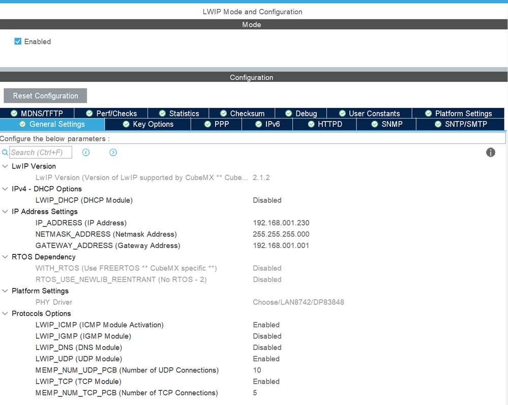

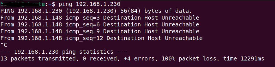

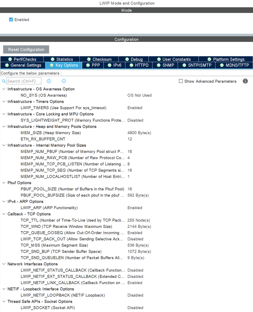

I have an XCore407I board with an Ethernet port installed. I'm trying to create a simple UDP server in Stm32CubeIDE. Compilation and uploading to the board is OK. But the board doesn't respond to ping and isn't visible in the router's device list.
Here are my settings in IDE.
Here is the main code.

}Unfortunately, I can't attach the entire project here. But I can add code from other modules upon request.
Can you tell me how to set this up correctly so it works? Thank you.

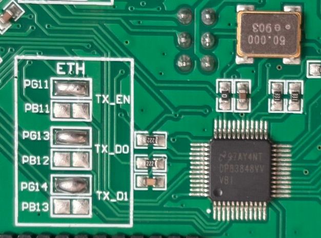

The web page for that board contains some downloads related to ethernet, for one - "stm32f4 IAP ETH".
It is a source project for a ST STM32F4 board with DP83848 PHY. Does the board actually have the DP83848?
Try to use these sources, as the board vendor recommends them.
2026-02-11 1:27 AM
Board have DP83848. See photo:
Sources on vendor's site is outdated and not for Stm32CubeIde. I can't compile them.
