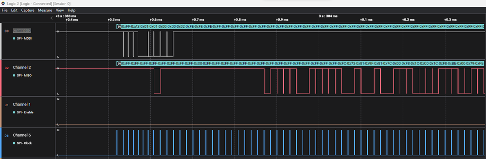

I've tried to display the SD-Card SPI via a logic analyzer, but I'm not quite sure what I've to expect:
Kind regards
