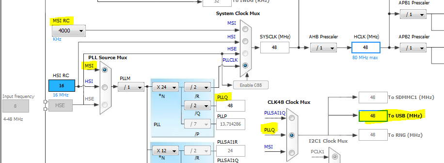

I'm working on a USB CDC project to get a virtual com port using an STM32L476VG processor, I have it configured to be a device only in hopes to simply pass information over the com port between my board and PC. I am able to trigger the interrupt when the USB connection is made, but I am not able to have the computer identify the USB. I set everything up in the STM32Cube application and have the latest virtual com port drivers installed from ST. I was able to run essentially the same USB style on an STM32L476G-EVAL board, both projects configured the exact same in everything with regards to the USB. Are there any suggestions on how to handle the Unrecognized USB for my main board I plan to be using? I've already confirmed the interrupt occurs and that I have the correct drivers installed, I'm just not seeing it be recognized correctly.

The rest of the pinout is different from the EVAL board, however I still have a 48MHz clock set for USB as configured by STM32Cube utility on my custom board.

I'm using the multi-speed internal (MSI) oscillator for the STM32L4 family of processors which ST states to have an accuracy of ±0.6%. I guess I may need to look more closely at the clock to ensure it actually runs at the specified speed.

I can check for another available clock to work off of with the settings, but I was able to verify with a frequency counter that my MSI clock is operating at the specified 48 MHz, there is a minor offset of about 8800 Hz but that wouldn't be enough to cause problems, would it?

The HCLK ended up being the problem where ST auto-generates code in the HAL_PCD_IRQHandler() for uint32_t hclk to be at 80000000 which isn't a problem if your HCLK is configured for 48 MHz or higher, but ours was at 24 MHz. Still running into an issue with running at the 24 MHz but am working around it!We’re moving the ST Community to a new platform to give you a better and more reliable community experience.
