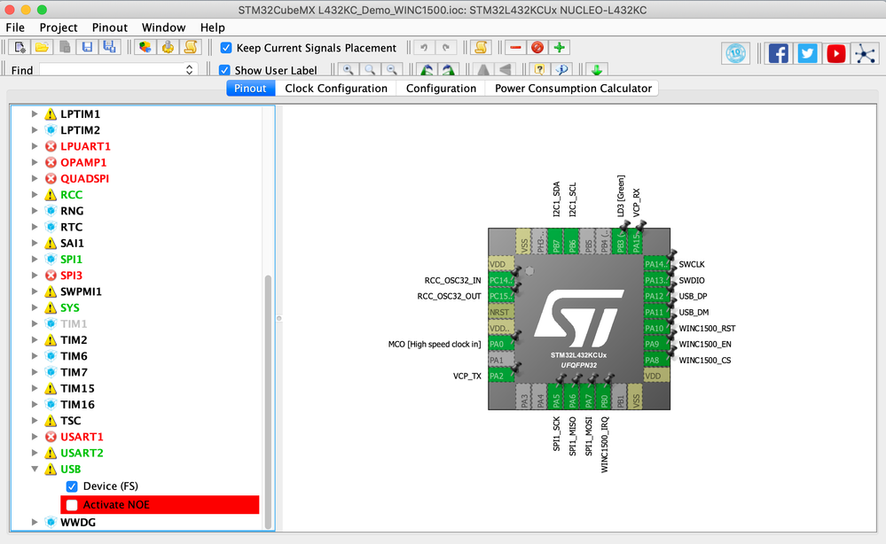

I'm currently working on a self-powered project that uses an STM32L432KC. From reading AN4879 I see that I have to enable VBUS sensing because it is mandatory for self-powered USB devices. Using CubeMX, I cannot enable VBUS sensing for the MCU. Is there an application note or reference implementation on how to proceed? Can I integrate VBUS sensing into the Cube Middleware for any Pin of the MCU?

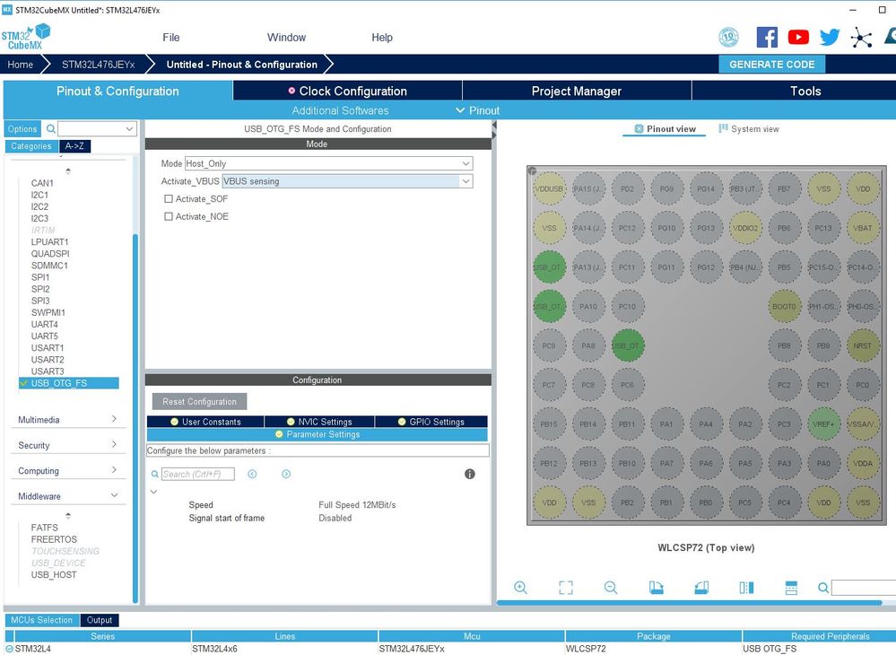

2019-04-03 8:46 AM
It seems STM32L432KC does not support USB_OTG_FS and VBUS Sensing.
In case, you choose another MCU with similar feature of STM32L432 and with USB_OTG_FS, you can enable USB_OTG_FS in STM32CubeMX, choose Host_Only mode, then activate VBUS sensing (see screenshot below).
