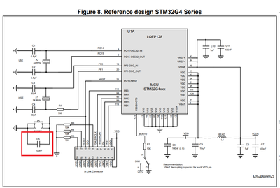

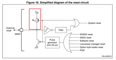

That's weird. There is an internal pull-up resistor inside the chip. Refer to the reference manual RM0440:
It should work without adding an external pull-up resistor on NRST pin!
However you need instead to add a filtering capacitor of 100nF on NRST connected to the ground:
Please refer to the reference design in AN5093 "Getting started with STM32G4 Series hardware development boards" / Figure 8.
