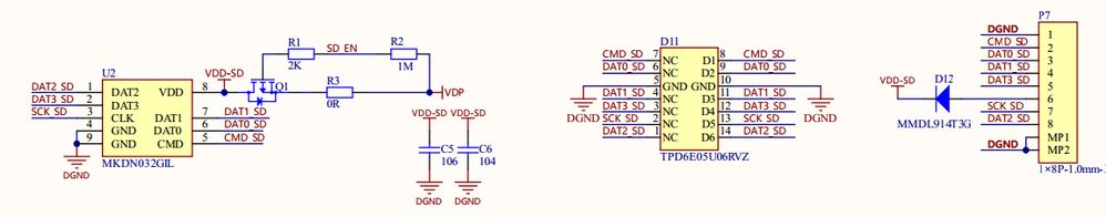

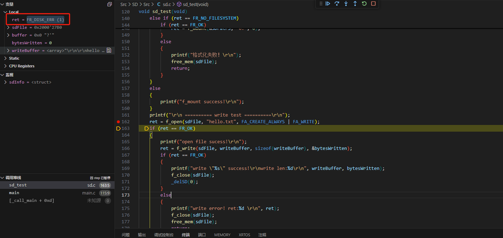

}This is my code, which is generated by cubemx using STM32L431 code. The logic of the code is to first call the openSD() function in while (1), reconfigure the IO port of SDMMC, and then turn on the power supply of the SD card. After the SD card is successfully written, it will call _delSD (0); SDMMC will be enabled inside, and SD card power will be turned off, then enter STOP2 mode. This mode wakes up in LPTIM interrupt, and after waking up, SystemClock_Cnfig() is called again; Then my question is why FR-DISK-ERR (1) is returned in f_open?
