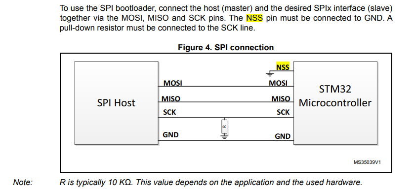

Hi @dmanc.1900 ,
That is an interesting case requiring some investiguation.
A quick check in AN2606, it is precised that NSS must be connected to the ground:
This is said, your proposals remain valid & I'll share with our Bootloader Experts.

2022-04-07 12:25 PM
The bootloader is not supposed to set *any* pin to output (including AF turned to output by the associated peripheral), until the protocol associated with that pin is initialized. In case of SPI, until NSS is pulled down AND master has sent Synchronization Byte (0x5A), as per AN4286.
If it does otherwise, I consider it to be an outright - and frankly, a very unsettling - bug.
Now what the bootloaders are already known to do (although, characteristically to ST, entirely undocumented) is, that they switch pullups/pulldowns upon activity directed towards given peripheral.
So, the question for @dmanc.1900 is: what you observe on SPI1_MISO (PA6), is a "hard" output, or a pullup? (i.e. what's the impedance of any circuit connected to it, and if decreased e.g. by using a suitable external pulldown significantly lower than the nominally 40kOhm internal pullup, does the behaviour change?)
If it is a "hard output", do you have, with the pristine mcu, any activity on the SPI pins, which can be interpreted by the target as 0x5A?
Btw. you can check bootloader's behaviour on the pins yourself, using a debugger, just put the mcu into bootloader mode, stop in debugger and read out and check the relevant SPI and GPIO registers' content.
