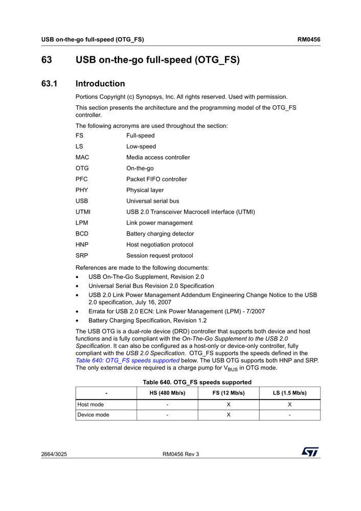

Well, the STM32U5 is not 'device-only', but Full-Speed only, sorry.
2022-04-07 7:34 AM
> Can you tell me if the STM32U5 series are also using the 'device-only' IP ?
No, it's the Synopsys OTG module.
