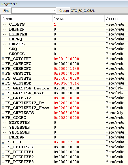

Just getting back to this. Not sure how I missed it before, but for the project that is not enumerating properly, the BSVLD bit in FS_GOTGCTL is NOT getting set, indicating the "B-session is not valid". Not entirely sure what this means, as in neither case do I have VBUS sensing enabled (VBUSBSEN and VBUSASEN in FS_GCCFG are both 0).

What is content of OTG_GCCFG ?
2022-03-10 6:23 AM
I found a difference in how PA9 was set but it seems inconsequential; in the "working" project PA9 wasn't init'd at all (so I assume tri-stated). In the non-working project, it was init'd as an input with no pull-up, which I think effectively makes it also tri-stated. Either way, removing the init made no difference.

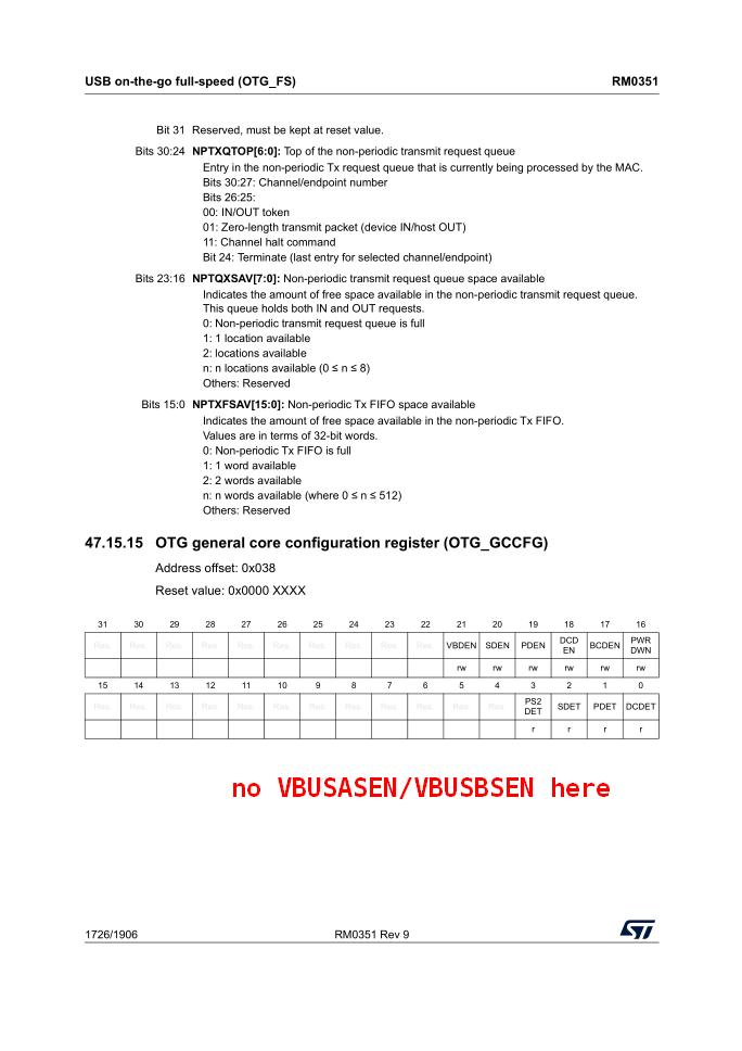

The contents of OTG_GCCFG are identical for both: the only bit that is set is the VBUS Enable Detection bit (VBDEN, bit 21).
2022-03-10 6:35 AM
This does not make sense.
If you don't use PA9 to detect VBUS, you should have VBDEN cleared.
OTOH, if OTG_GCCFG.PWRDWN=0, the USB can't be working in either case.
How comes you have VBUSBSEN and VBUSASEN in GCCFG, on an 'L496?
2022-03-10 6:58 AM
Ah, that's because I (foolishly) trusted IAR to be giving me the correct names for the bits in the register:
2022-03-10 7:04 AM
I apologize, I had a breakpoint inserted at the wrong position. After calling USBD_Start, the working project has ONLY PWRDWN set. The non-working project has PWRDWN AND VBUS Detection Enable set. So it looks like I need to figure out where VBDEN is getting set, and eliminate it.
