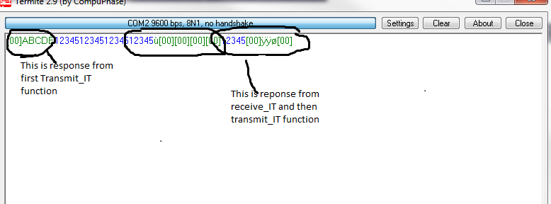

I am trying to configure USART1 on Nucleo-32 board using HAL. Code is suppose to first it receive the message and then it transmits the same message.
My problem is RDR is showing reading garbage value. Can someone point out was is wrong?

2018-10-19 2:08 PM
if you mean by clearing rx_cplt flag, printscreen is after I have cleared flag in main loop. As I have mentioned it earlier, that even if I debug my code my RDR show 0c0,0xf8 etc.

2018-10-24 10:27 AM
Sorry for late updates. I have solved this issue. There was couple of problems
1) connection between Trans receiver and Computer were wrong
2) the was more then 3% error in my baud rate
4) as pointed by BobS, timing issue
