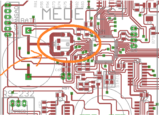

Take a look in my PCB attached (this picture show near of STM32 and Xtal (mc306)... ) a orange circle in part of PCB of RTC.2016-05-02 7:31 AM

Looks like a two layer board with some scary power routing. Again, going to suggest you walk through your design, and review PCB methods, with your local FAE.

Hi, yes is 2 layer... I already see the layout many time... It s me who build and route this board... I can t see something wrong...
About the timeout.... I don~t have timeout... infinite loop.... I always test in LSE first and wait... if I see don t start I download a other firmware that use LSI....In my test dont have timeout.... and a wait many time... 2 minutes or more... in my test... really dont start...In my experience I think the route in PCB is ok.... can see nothing wrong... but maybe there is something wrong I dont understand.. I dont know.....We’re moving the ST Community to a new platform to give you a better and more reliable community experience.
