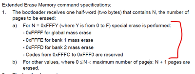

2024-01-09 6:53 AM
I have the reply I was looking for:
the extended erase command is supported, but only for the single page erase, i.e. it is not possible to perform the 'special erase' described in the application note AN3155:
Here there are the byte sequences:

2023-12-21 7:59 AM
The link you have is pretty conclusive, it just isn't supported here, bizarrely. Bummer.
> I checked and this device (as well as for example STM32L1 series) do not implement the mass erase in the bootloader. The BL code space was simply too small on this device to fit the mass erase. Sorry.
Should be able to do page-by-page erase though.
