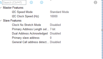

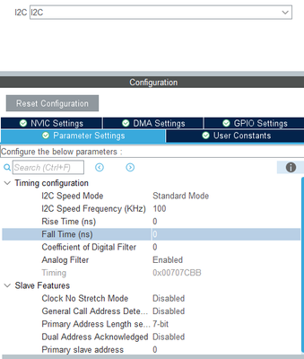

Perhaps there is an issue with my I2C config:
I dont recall that I had to manually set Rise and Fall time parameters. I have tested the I2C on the stm32f407 and that microcontroller does not even have such options:

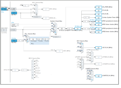

Also, Could there be an issue with my clock settings:

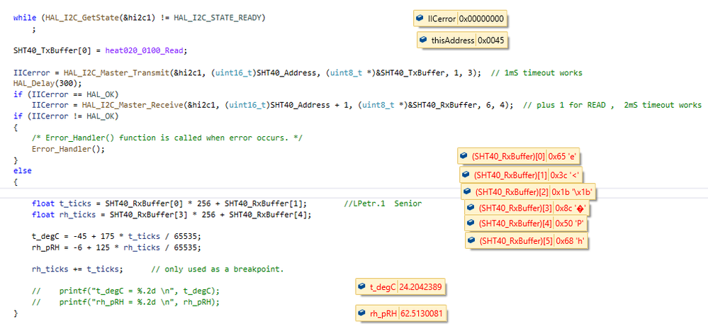

The cube suggested for 100KHz operation, the Timing configuration value 0x00000002, which didn't work,
I incremented and tested values 3,4,5,6,7,8,9,a,b,c  manually in main,c, found 9,a,b,c all worked ok.
Adjusted the cube to run the IIC at 48KHz producing a timing config of 0x0000000A  and it all runs sweet.
But then, the address is different for these chips, SHT40 can be address 0x44,0x45,0x46.
I had to run a check on the actual SHT40 address and found this one responds to 0x45 addressing.
