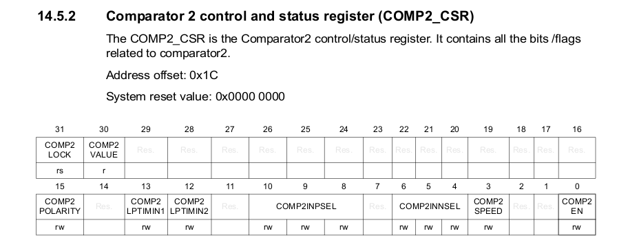

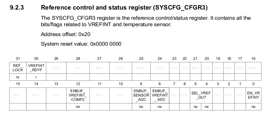

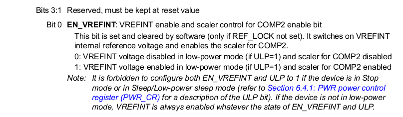

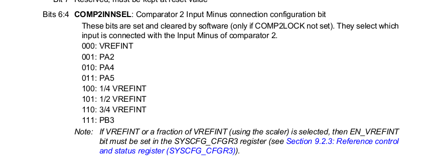

I was having some issues with getting comparator 2 working on my STM32L011K4 (Category 1 Device). I was trying tocompare a voltage on PA7 with 1/2 VREFINT. It wasn't working the way I intended it to. I dug further into the documents and found that the Low Level Drivers (FW_L0_V1.0) provided by ST is missing a bit field that is important to getting comparator 2 working with scalar VREFINT.

SET_BIT(SYSCFG->CFGR3, 0x1); // Setting EN_VREFINT to '1'
This workaround seems to have worked for me. I hope this is the issue and if so, gets fixed on the next version of the firmware.
