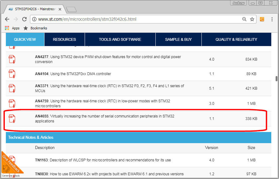

Seem to remember seeing an application note, but not a very efficient. One could emulate output with SPI or TIM

The principles are going to be the same as for any microcontroller.
Always worth going to the Product Page for the chip concerned and looking at the list of Application Notes; eg,
Which is the one that
Turvey.Clive.002
alluded to, andGolab.Bogdan
linked.But why not just choose a variant with sufficient real UARTs ... ?
