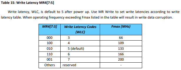

it says that the default maximum read and write clock is 133Mhz, see page 16 and 18:
It also says:
"Write latency, WLC, is default to 5 after power up. Use MR Write to set write latencies according to write
latency table. When operating frequency exceeding Fmax listed in the table will result in write data corruption."

Any updates on that issue? We saw that a new CubeMX Version STM32Cube_FW_H7RS_V1.2.0 was released in the meantime, but the external RAM frequency is still set to 200 MHz although the Datasheet clearly states a maximum of 133 MHz as default value.
This will probably lead to RAM corruption under some working conditions (high/low temperature environment, etc.).
