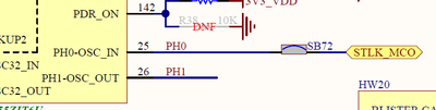

Which board are you using? Nucleo board?
If it's the case, you need to set HSE in Bypass mode as the clock source is provided from the STLINK (STLINK_MCO) and there is no crystal on the board:

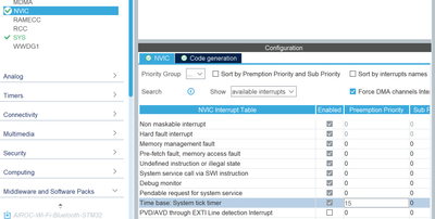

2025-11-04 1:11 PM - last edited on 2025-11-04 1:18 PM by Andrew Neil
yes. I am on a nucleo board. I tried setting HSE_Bypass but it didnt change the behavior. The Config method fails on the method
HAL_InitTickBecause of what seems to be an invalid TickPriority of "16" which is somehow present.
Edited to apply proper source code formatting - please see How to insert source code for future reference.
2025-11-04 1:41 PM
16 is not a valid priority. Change it to 15 or less.
Include your IOC file if you're having trouble.
