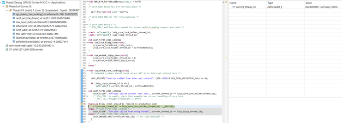

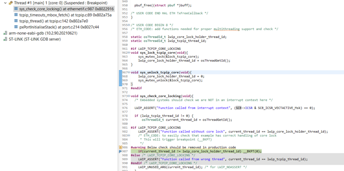

Using the example code, I see one issue with the core lock - if the breakpoint in ethernetif.c line 987 is enabled I see the code suspends in places one would not expect it to suspend such as:
If I disable the breakpoint, ping works ok.

2023-11-23 5:17 AM
When the BKPT hits, what is the thread id?

Greetings,
for the thread ID, see below.

2023-11-23 10:47 AM - edited 2023-11-23 10:50 AM
Hmm, the call stack shows that netif_set_link_down() expects to be called under the LwIP "core lock". ... I'm not sure whether this function actually requires the lock, but lets assume it does. So acquire the lock in your low_level_init() and other places around calls to netif_set_link_down, netif_set_link_up.
