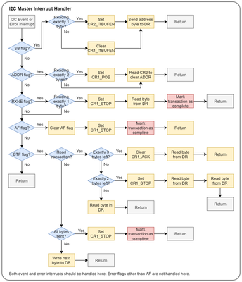

From experience, the I2C peripheral is extremely complicated on the STM32F4 series and writing an interrupt handler to handle every situation requires some skill. By comparison, the STM32H7 has a much easier to work with peripheral.
The STM32L1 series looks to have the same peripheral as the STM32F4, except it's missing the FLTR register. Perhaps it's slightly different, but it looks pretty similar so the below should help.
This is a flowchart for how to write the event handler you're looking for on the STM32F4 and will likely be similar for you.
The code you posted has multiple bugs associated in it, but if you follow the flowchart to correct it, it should work. Good luck.

2023-11-28 9:34 AM - edited 2023-11-28 9:35 AM
2023-11-28 10:24 AM
Wow! That chart is amazing! That actually makes some stuff a lot more clear! And it does look as though it probably matches the STM32L peripheral. Thank you!
Also, I'm not at all surprised the code is buggy. No doubt it works for the few peripherals we were using, but has bugs that keep it from being more general.
2023-12-02 10:11 AM
I have solved my problem, not exactly by following the chart to the code specified, but the code and chart did help me to better understand how the peripherals work. The fix can be described in the chart, or in my code. In both cases, there is a read transaction going on and there are exactly three bytes left when the BTF flag is set (line 68 in my code). The event chart shows that one should clear CR1_ACK and then read a byte from the DR. This is what "my" code did. But what I had to do was add a call to I2C_NACKPositionConfig(I2C1, I2C_NACKPosition_Current ), which essentially clears CR1_POS. I'm not entirely sure why it was not clear in the first place (as the chart clearly assumes) but that made the difference. It appears that it should have been set in this code only if there were exactly two bytes to receive. Perhaps it was left set by a previous 2-byte transaction (in which case, the chart really should do it as well).
It appears to me that there are a couple difference between the STM32F and STM32L...at least the documentation seemed to imply a few differences from what the chart does. But in any case, I did not want to re-write the entire driver (since someone else "owns" it) but this change fixes the problem.
Thanks for all your help. I'll mark the chart as "accept as solution" to get it off your books; besides, it was really helpful if not the exactly solution.
