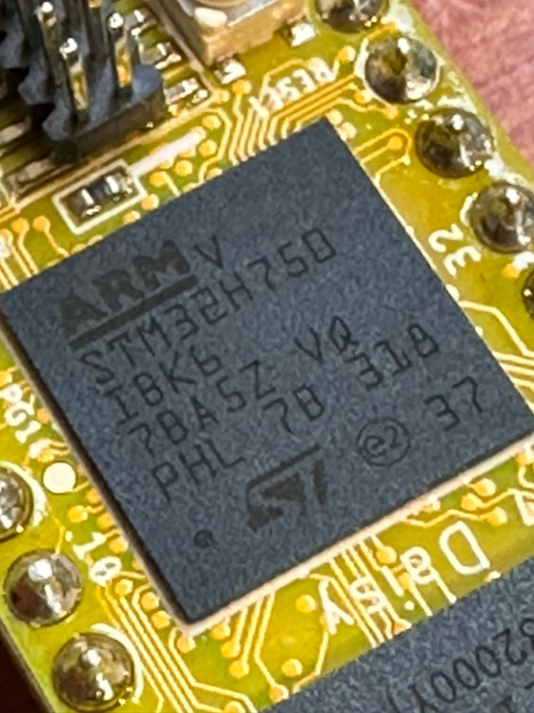

My primary concern would be with the VCAP capacitors, either one 4u7 or a pair or 2u2
Inadequate, low ESR, capacitance here is the source of a lot of quirky behaviour
Here's a picture.
Looks like it's 2 of the 2.2 uF caps, one on each VCAP pin.  Don't have the part number, however.

Looks like a 'V'

Should see 1.25 V on the + side of the VCAP's, you could perhaps look at supply stability there, and the 3.3V rails.
