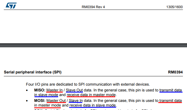

The RM suggests that the direction of the pin does depend on whether the peripheral is in Master or Slave mode:
A fine example of data that would have been much clearer if presented as a table

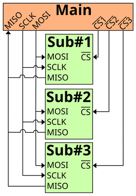

The names say it all:
MOSI = Master Out, Slave In;
MISO = Master In, Slave Out.
@SidPrice wrote:Is master MOSI -> slave MOSI and master MISO to slave MISO correct?
Yes. This is standard SPI - nothing specific to STM32
https://en.wikipedia.org/wiki/Serial_Peripheral_Interface

Thank you, yes, I fully understand that. Perhaps I should have been more specific.
I am concerned about the connections on the STM32L4. PA6 is SPI1 MISO, PA7 is SPI1 MOSI. So, when the L4 is a slave, the master MOSI is connected to PA6 or PA7.

@Andrew Neil Thank you, I missed that in the TRM.
I think I should be able to put Master MISO on PA6 of the slave and master MOSI on PA7.
