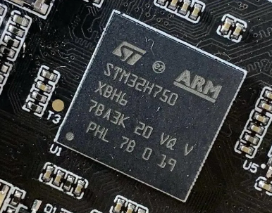

> how do we know for sure?
just look on your chip: is there a "single" V or Y on it ? (right/bottom in pic , here V .)
There's neither a V or Y or anything after the 'VQ'
Its somewhere... just a single letter, V or Y or Z ...
V:
Z:
VQ is the Fab/Diffusion Line,  "VQ" for ST Crolles CR300 (France)
An any case a quick, in-focus picture would clear this up quickly.
A large number of Y parts for the H74x/H75x have shipped in recent years.
