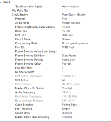

SAI4 - PDM using MicroPhones pairs (1-2) and CK1 as clock, DMA is also setup, Mode: Circular, Data Widths: Half Word, Increment Memory

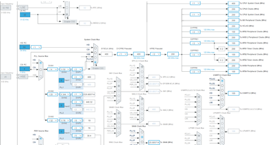

Clock Configuration:
