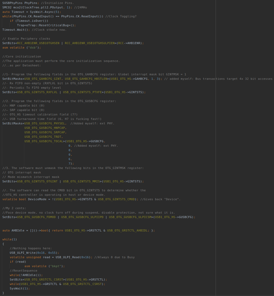

I reimplemented things myself out of desperation. Nothing works. But this is a condensed minimal implementation that should work. I adhered to the Datasheet to the letter. What is wrong?
Its C++ syntax. I hope to those who are unfamiliar with it, that it makes some contextual sense.
WTF. Cant paste my code. The forum does remove my template parameters...
For those who dont trust pastebin :D
Why cant i do the most basic thing. The ULPI bus is completely silent. Not a single line toggles.

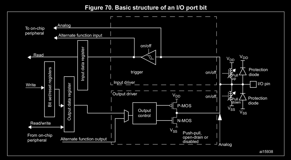

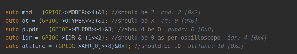

According to the Datasheet one can read the digital input state of a pin even if it is connected to an alternate function input. Basicall GPIO->IDR always reflects the pin state except in analog mode.
Now, after every register write i just sample the GPIOs and save them in a history.
AND LOOK AT THAT!
The DIR pin is always sampled as HIGH in the IDR-register. (that means the ULPI-Bus is not open for communication)
Well, the truth is, DIR is LOW on the oscilloscope!

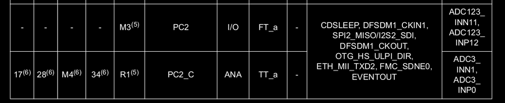

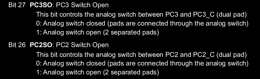

Now, ULPI_DIR is "PC2_C" on my package (H750 in LQFP100) which is somewhat a weird pin.
Lets have a look:

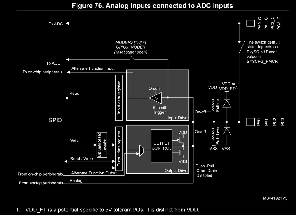

Ok. Whats annotation (6)?
Fair enough. So the switch must be closed. Which register? => SYSCFG_PMCR
Ok... So lets see.
So... everything should be OK.
WHYYYY is the pin reading HIGH when its LOW??
What could be a reason the analog switches arent working?
Just a double check: reading back the PC2 gpio settings: (everything is ok here, except IDR)
