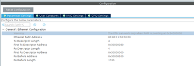

MEMORY
FLASH (rx) : ORIGIN = 0x08100000, LENGTH = 1024K
RAM (xrw) : ORIGIN = 0x10000000, LENGTH = 128K /* ETH_CODE: split memory to data and ethernet buffers */
ETH_RAM (xrw) : ORIGIN = 0x10020000, LENGTH = 160K /*added*/
So which is the correct address for RAM in CM4 ? please guide us on the same.
