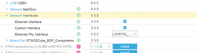

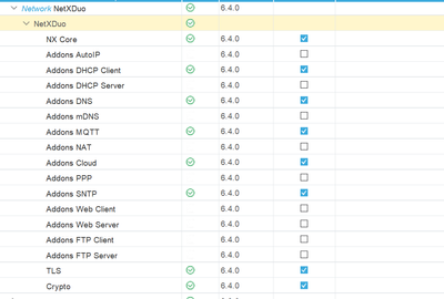

2. But i need to connect to Azure IOT via Azure c sdk i have added those and removed mqtt, freshly gen required things via cubemx using X-CUBE-AZRTOS-H7 and dhcp as client and ethernet (RMII) in interrupt
3. During assign ip via DHCP ip is not assigning and the ip_address_change_notify_callback() was not triggered i have followed same as NX_MQTT_Client but still it is not assigning
