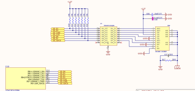

We are using the Part#STM32H745XIH6 in our current product and it is going to be use in production.
We are very near to release the product but at last we are facing the issue in the SD Card communication and below are the details.
At power ON, SD card is detected by the STM32H745XIH6 then it check for the Mount status and it is also successfully mounted. Now STM32H745XIH6 is going to create the file SQLITE and SQLITE-PU files on SD card but the process is stopped and stay at the SD card initializing stage.
We also check the SD card data but nothing is created in SD card...
Please find the Image of the connections for your reference.
Kindly provide the valuable suggestion to clear out the issue to move the product in production.
Regards,
Alpesh

2024-07-01 8:55 PM
Thank you for the guidance. I will try with the mentioned solutions and update here with the log.
Meanwhile I want to know that I am able to measure the clock(24MHz), cmd, data and cd on CRO. We can see that the cd pin goes low when sd card was inserted and default is high.
As we have two board, out of them, in one board sd card is working and other board sd card is not working, Here the hardware and software are same in both the boards.
Can you please confirm that the issue is whether hardware side OR software side?
so we can focus on that part as the schematic is attached in this post previously.
Regards,
Alpesh

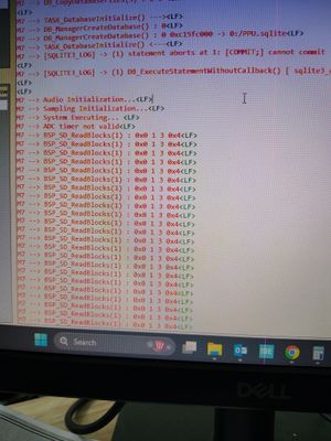

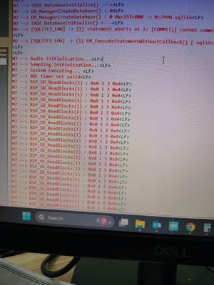

2024-07-04 5:40 AM
I have checked the Hardware connections and make rework.
After rework, the SD card communication is started but after few minutes, it was showing the error. Again, start the board and the same situation observe like after few minutes, it shows the error.
Also attached the log images for your reference.
Regards,
Alpesh
2024-07-04 6:19 AM
-- Did you ??
How should i know, what the ...read 1 3 0x4 is meaning ?
