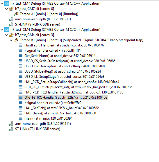

But when I debug the code it enters hardfault at m4 project stm32h7xx_it.c.
it stays in this handler for a while and after that enter hard fault handler.

here is the call stack .

I seem to recall that the M4 core can't access the UID which it uses to generate the serial number. No doubt examining the SCB registers would show this, or stepping through the code.
Go into Get_SerialNum and hardcode the serial number instead.

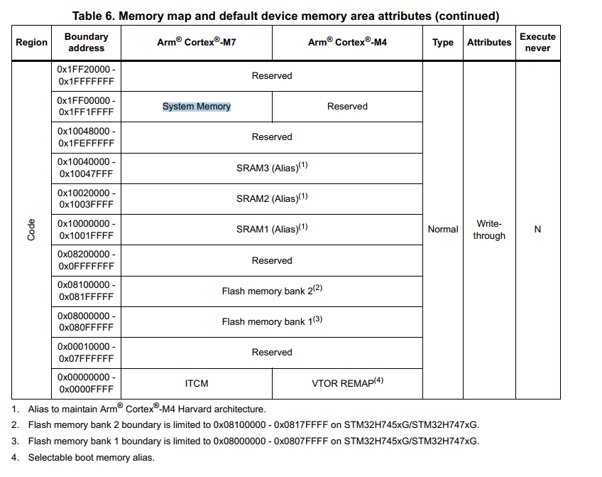

I did not expect this result.I think the genereted code needs to handle this stuation.
After that I check document of processor.
UID resgisters adres is this.
#define UID_BASE (0x1FF1E800UL) /*!< Unique device ID register base address */
when I check the memory map as the image below.M4 at this location is reserved so only M7 read this.
Am I rigth?
Thanks for your help.
Regards.
EMRE
2021-09-03 12:04 PM
Yes, the M7 can read it and the M4 can't. As stated before.
