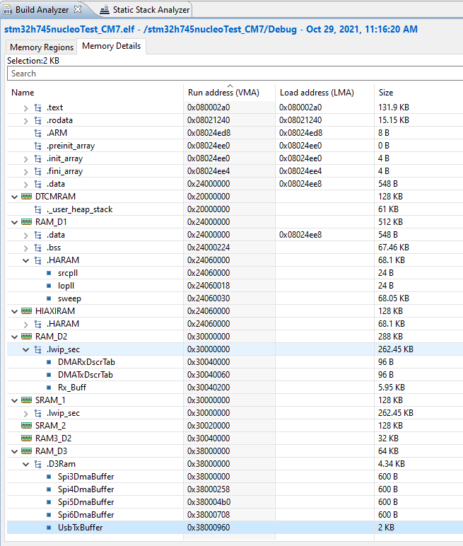

LWIP is hogging memory where it didnt oughta be.
...\ld.exe: section .SRAM2 VMA [0000000030020000,0000000030031033] overlaps section .lwip_sec VMA [0000000030000000,00000000300419cf]
but in the .ld file is allocated thus
/* ethernet Modification start */
.lwip_sec (NOLOAD) : {
. = ABSOLUTE(0x30040000);
*(.RxDecripSection)
. = ABSOLUTE(0x30040060);
*(.TxDecripSection)
. = ABSOLUTE(0x30040200);
*(.RxArraySection)
} >RAM_D2
Why does LWIP behave this way please?, what might I be doing wrong here?
It all seems to work cm7 wise(though clearly the CM4 core memory SRAM1,SRAM2 that aliases here is not available) . I have put the uncached dma buffer that was in CM7 SRAM in a block of axiram, but this is a bodge.
2021-10-29 4:47 AM
This seems to have fixed it, though I don't understand why it is necessary to create the additional memory sub region
"RAM3_D2 (xrw) : ORIGIN = 0x30040000, LENGTH = 32K":
*(.RxDecripSection)
*(.TxDecripSection)
*(.RxArraySection)
} >RAM3_D2
