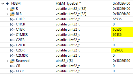

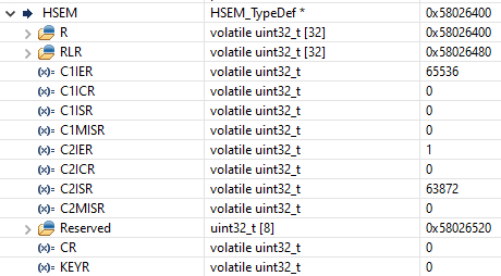

SEM_RESET(TR_EVENT, SEM_CM4);Before entering line 16, the content of the HSEM registers look as follows:
After line 16, the content is this:
So it appears the resetting of the corresponding semaphore properly sets the interrupt registers, but an actual interrupt does not occur. Anyone have some experience with semaphore interrupts? Who could steer me in the right direction to find out what's missing?
