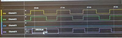

Read out and show content of TIM registers for the waveform you have posted, and describe what do we see on that waveform - which color corresponds to which channel - and tell us how is it different from expected waveform.

The logic picture shows that channel 2 is almost complimentary to channel 4

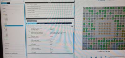

on the cubeMx you can see that channel 4 is not defined and the output pin of channel 4 is
also not defined.

> on the cubeMx you can see that channel 4 is not defined and the output pin of channel 4 is also not defined.
So, CubeMX, have you been through all the auto-generated source code and checked how this pin has been set up?
In case of doubt, check the GPIO registers, and even better: initialize this GPIO.

I have checked it time and time again
timer 3 channel 1 is defined PWM generation on pin pb4
timer 3 channel 2 is defined PWM generation on pin pc7
PWM on pc7 is the one that influence pc9 even if pc9 is not configured
