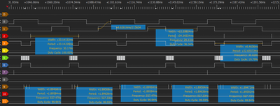

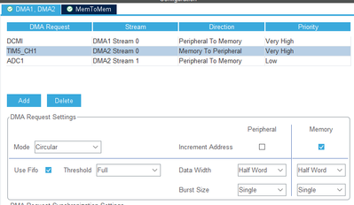

Seems like the issue is not related to the series resistor, but I replaced it to 10R. So here is the thing, I could manage to increase the parallel bus speed to 25MHz from 10Mhz, but it works only, if the audio capture is disabled. Without audio capture, the video stream runs smoothly. When I enable the audio capture, the DMA stream for parallel out is corrupted somehow... Both peripheral uses the DMA2 (Stream0 and Stream1). The DMA streams are configured as:
The TIM5_CH1 is the parallel interface clock input, it is configured for very high priority. The analog capture is on low priority. On the following picture you can see a "normal operation". CH9 is the interesting on, it shows the interrupt of the DMA2 Stream0, on CH5 you can see the parallel reading clock. Between two DMA interrupts we have ~1.895ms time.

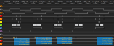

And here it is the corrupted one:
The third transfer does not finish properly, and the last dma interrupt occours at ~2.95ms instead of 1.89ms. But the first arrived in time. And you can see the impulse train on the paralel clock are "doubled" in each reading cycle, because the MCU did not signalized the end of the parallel communication and so the external controller started a new reading cycle.
I checked plenty of things in the code already but I feel like I lost in the woods...It seems like the DMA2 Stream0 and Stream1 got into trouble somehow. Or there is some bandwidth issues on the internal buses. If I change back the paralell read speed to 10MHz then everything works properly.
Any idea to look for?
